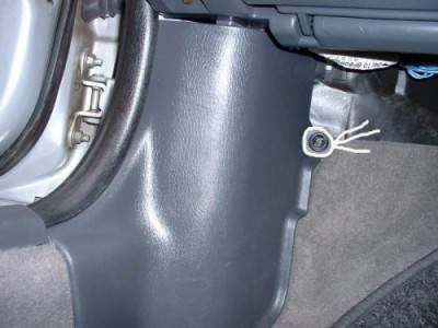

Step 1
Remove the door strip plastic nut and Kick plate (I removed to door strip and kick plate to prevent damage)

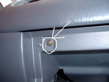

Step 2
Remove lower screws from under glovebox (2 off)

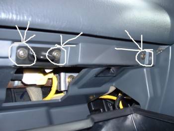

Step 3
Open glove box and remove screws (4 off) and remove glove box place somewhere safe J

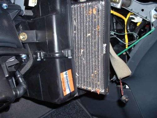

Step 5
Pull filter out ( you might need pliers)

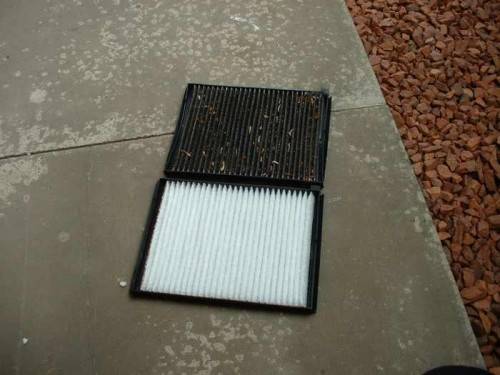

New and old Filter J
